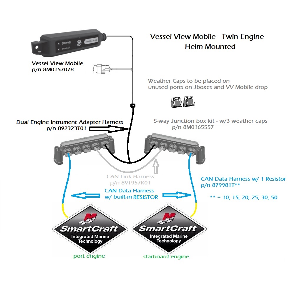

I spoke, once again, these are the components needed for the twin 8.1engine.
From merc direct
Instructions in email
May 31 22
1 vessel view mobile
1- Dual engine adapter 892323T01
2- j box 8M0165557
1- can link harness 891957K01
2- Can harness cables 879981T10
This is the installation instructions for the 8.1

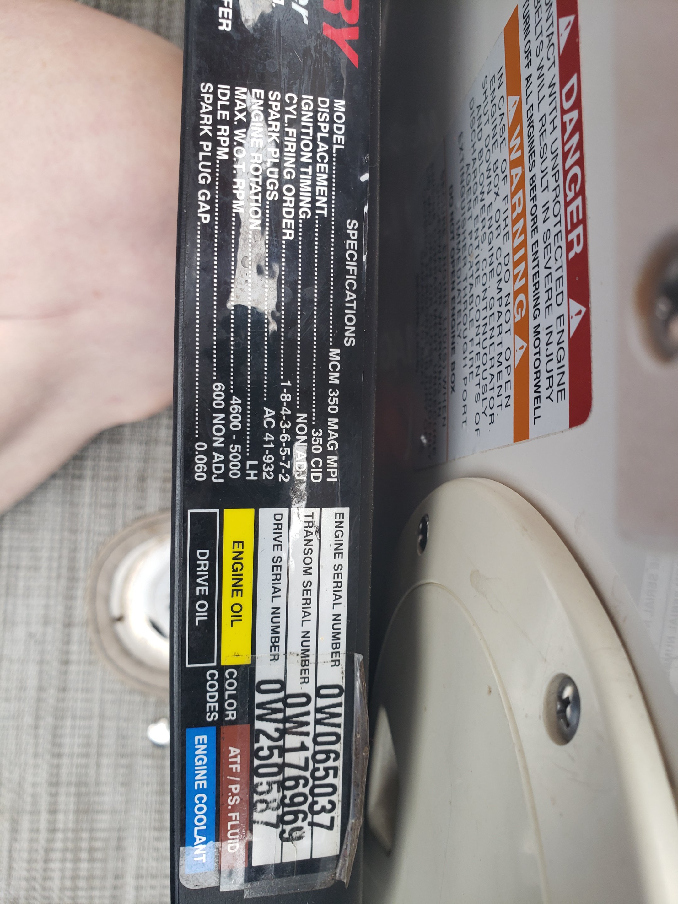

I am trying to install VesselView in my 06 256SSI with 5.7 Mag MPI but cannot find the connector to plug into. Any know where it is? I found a connector labeled CAN on the port rear corner but it did not have either red or yellow terminator and only had 5 wires . VV has 6. any ideas??

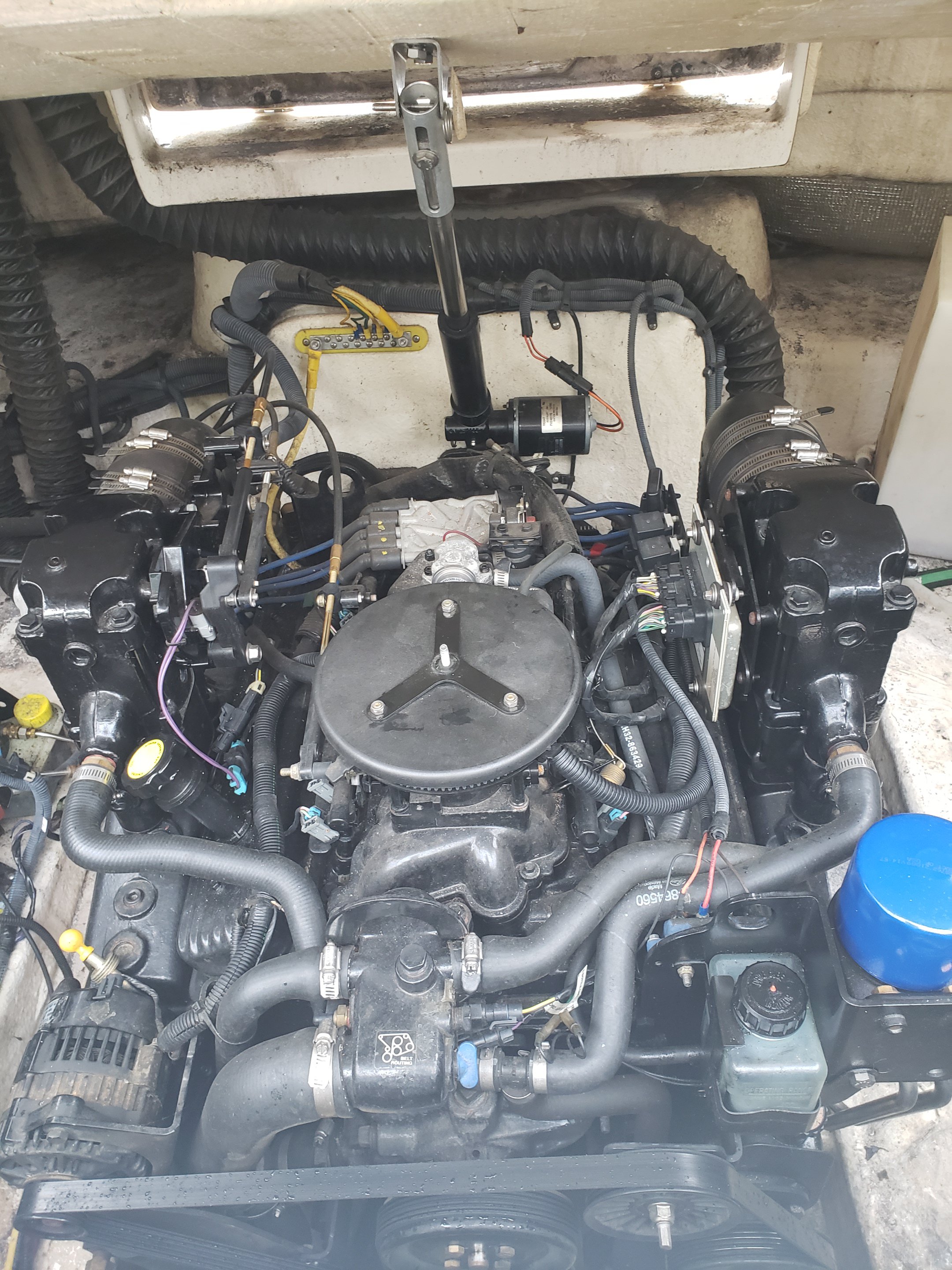

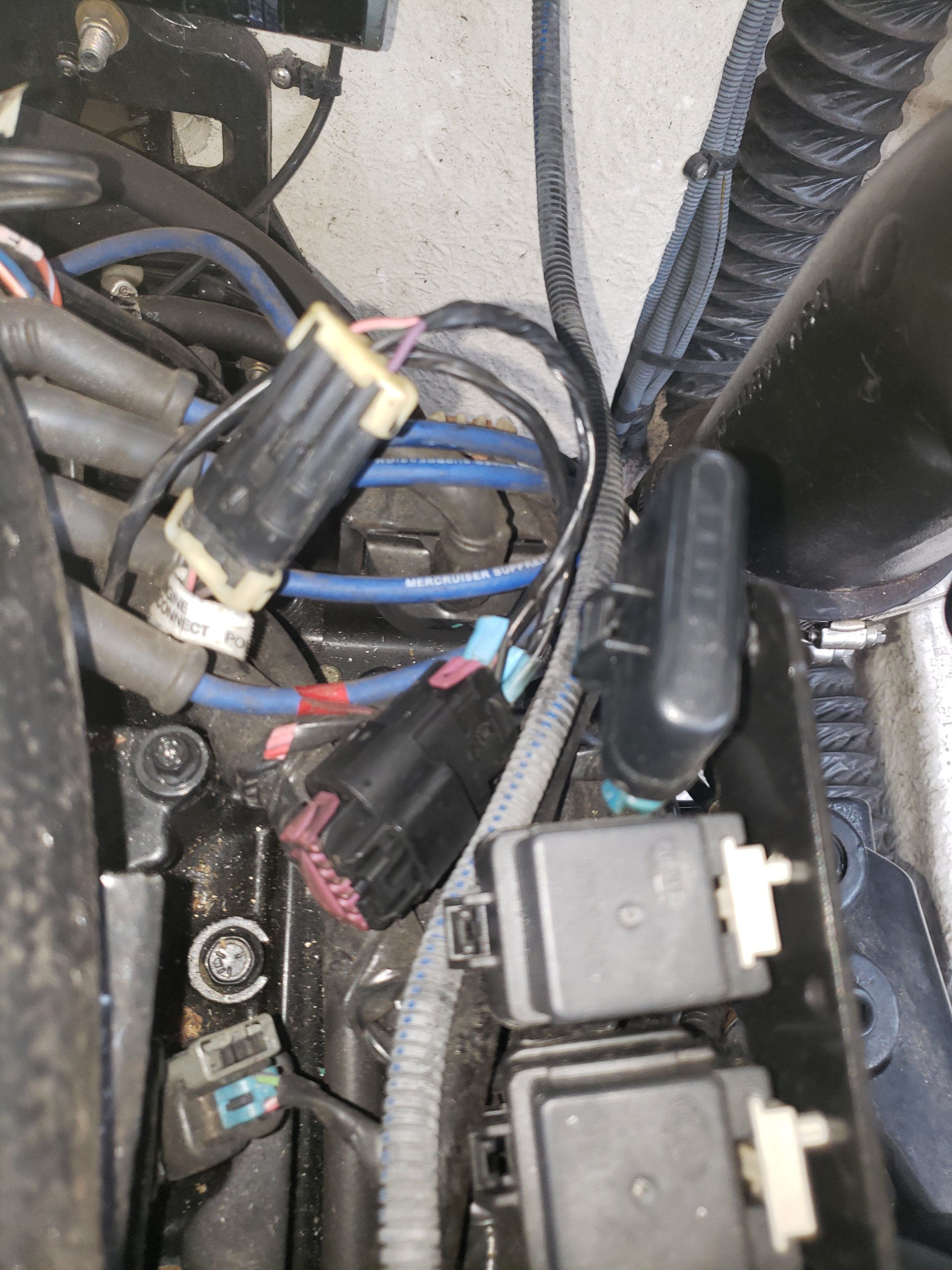

Success!! My is engine 2005 5.7 Mag MPI There was a purple weather cap on the SmartCraft port rather than a terminator. Plugged my VV into that plug and a yellow terminator I bought into the pigtail and all worked. Now I have to figure out how to use it. The primary items I am looking for is RPM and fuel usage. Plug was in Port rear corner of engine
