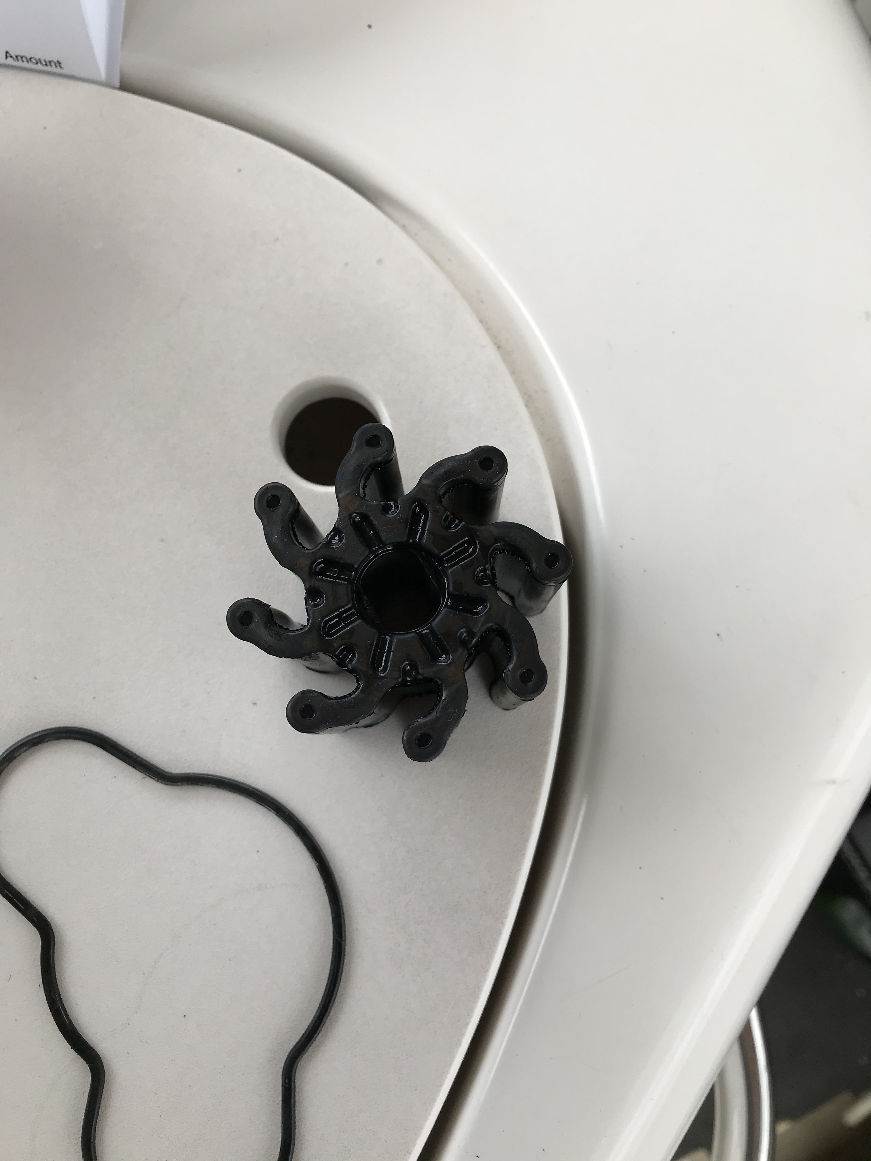

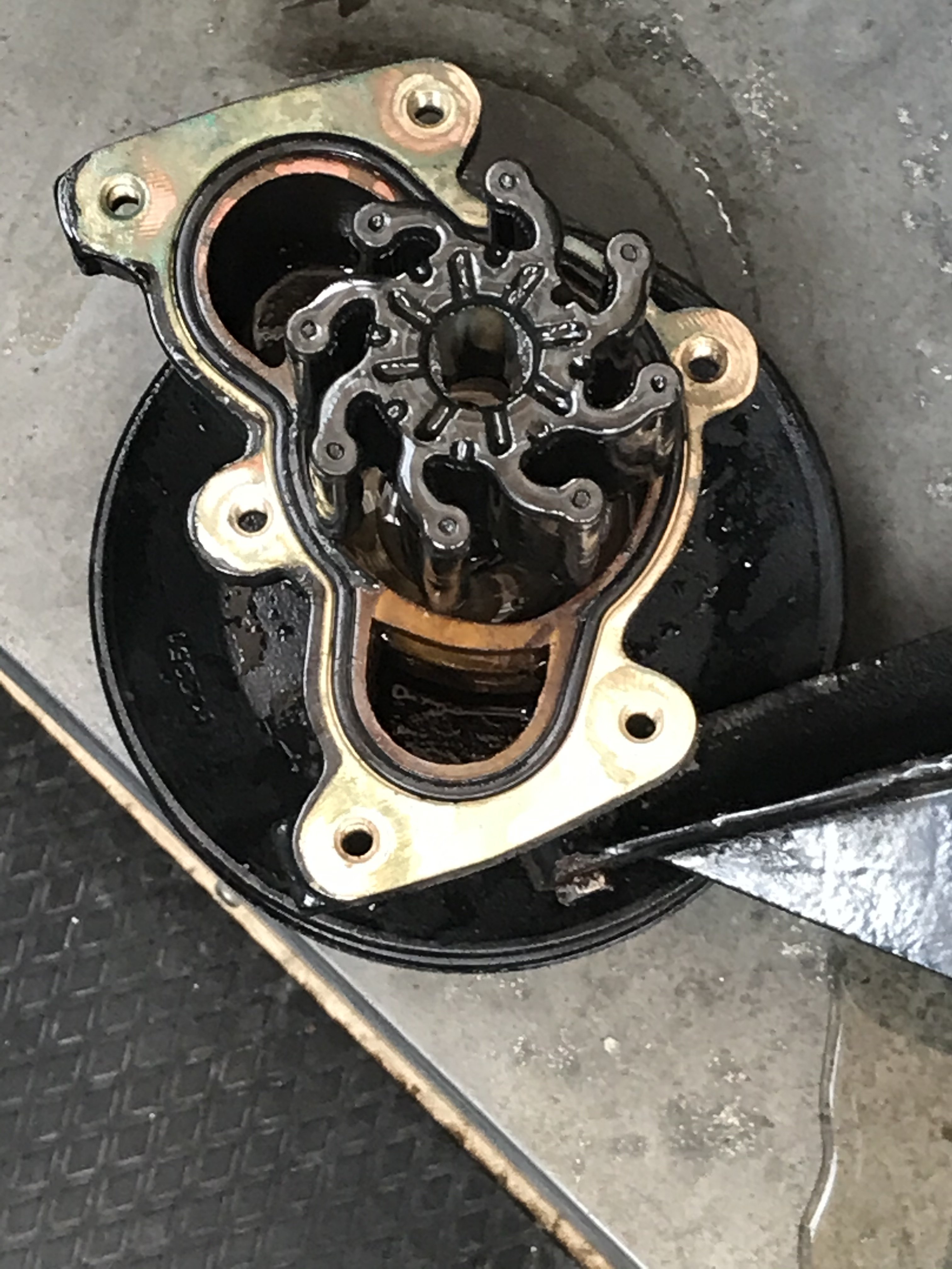

Starboard impeller wasn’t riding on the housing wall and therefore not pushing water through the cooling system. Did both engines, took maybe 1.5hrs start to finish. I’m floored how fast they failed.
