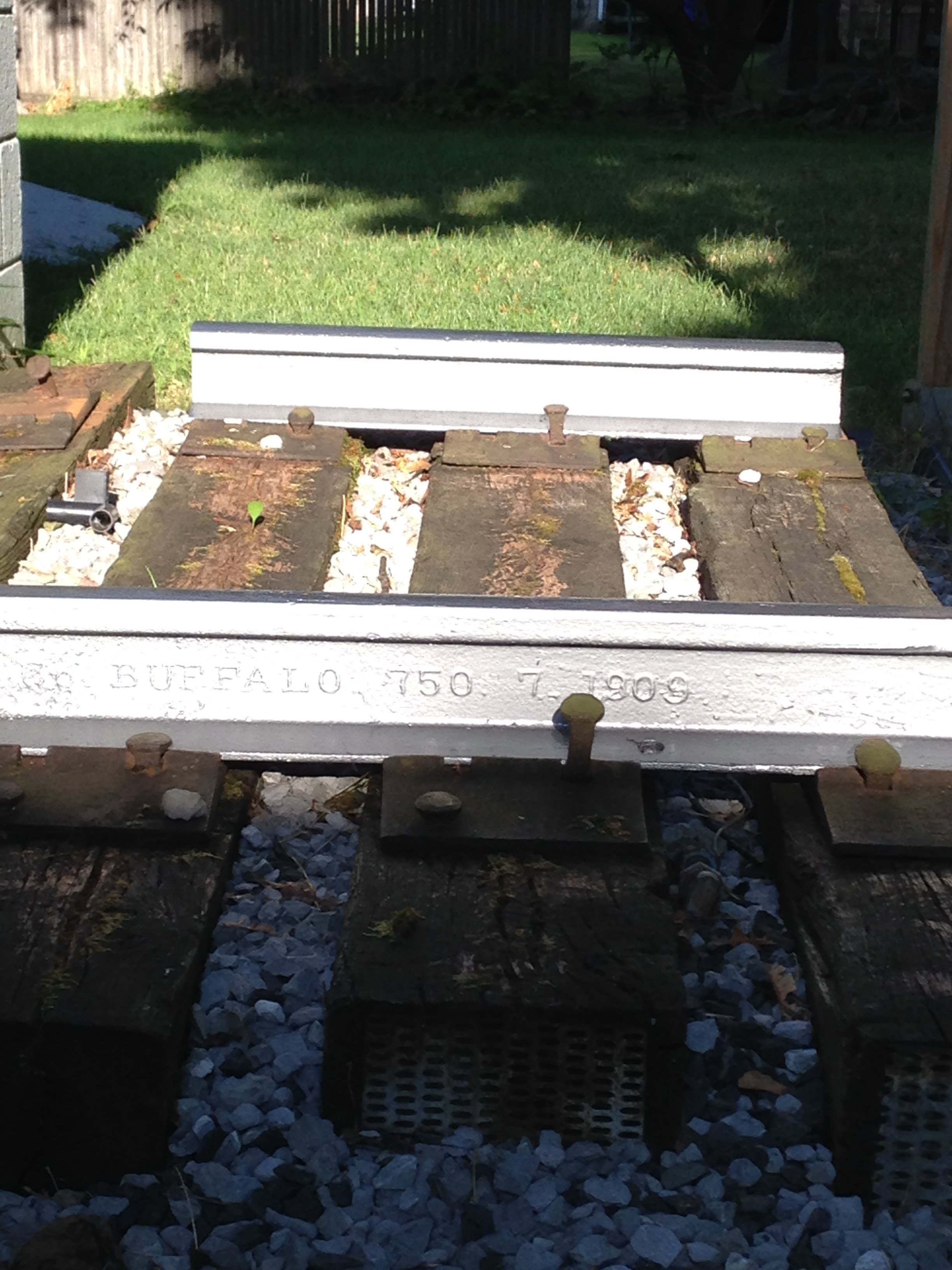

I have a small "sub-hobby" with railroads. I built a very small full scale track in my backyard. With the railroads switching to concrete I was kinda hoping to keep a little authenticity. But maybe I'd be generating more of a problem than I'm trying to solve.
Here is a picture of the small full scale track [notice the date]:
