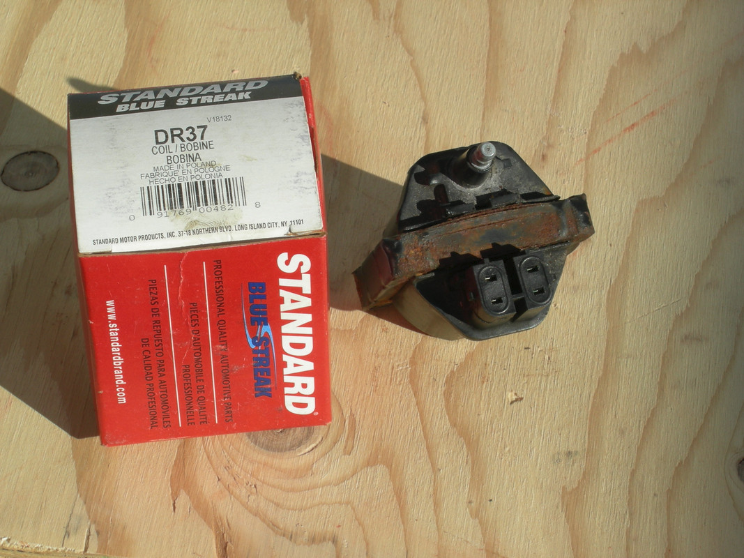

A minor flaw in there design of coil mounting at the rear of an engine. Water from washing,wave action ,rain,etc that get on the coil starts to rust and swell the lamination's resulting in a no spark condition. Should this happen inspect the steel lamination's for rust and swelling. Any GM coil can replace it by grinding off the rivets and replacing with nuts and bolts.-An added precaution is to spray heavily with CRC corrosion inhibitor on the coil when the install is complete and further protect it by placing a plastic cover over the engine to keep it dry. includes mounting bolts and nuts, all you do is drill out the rolled side of the rivets push them out.
and reinstall the bracket with the bolts and nuts
$42.00 at most good auto parts p;laces
