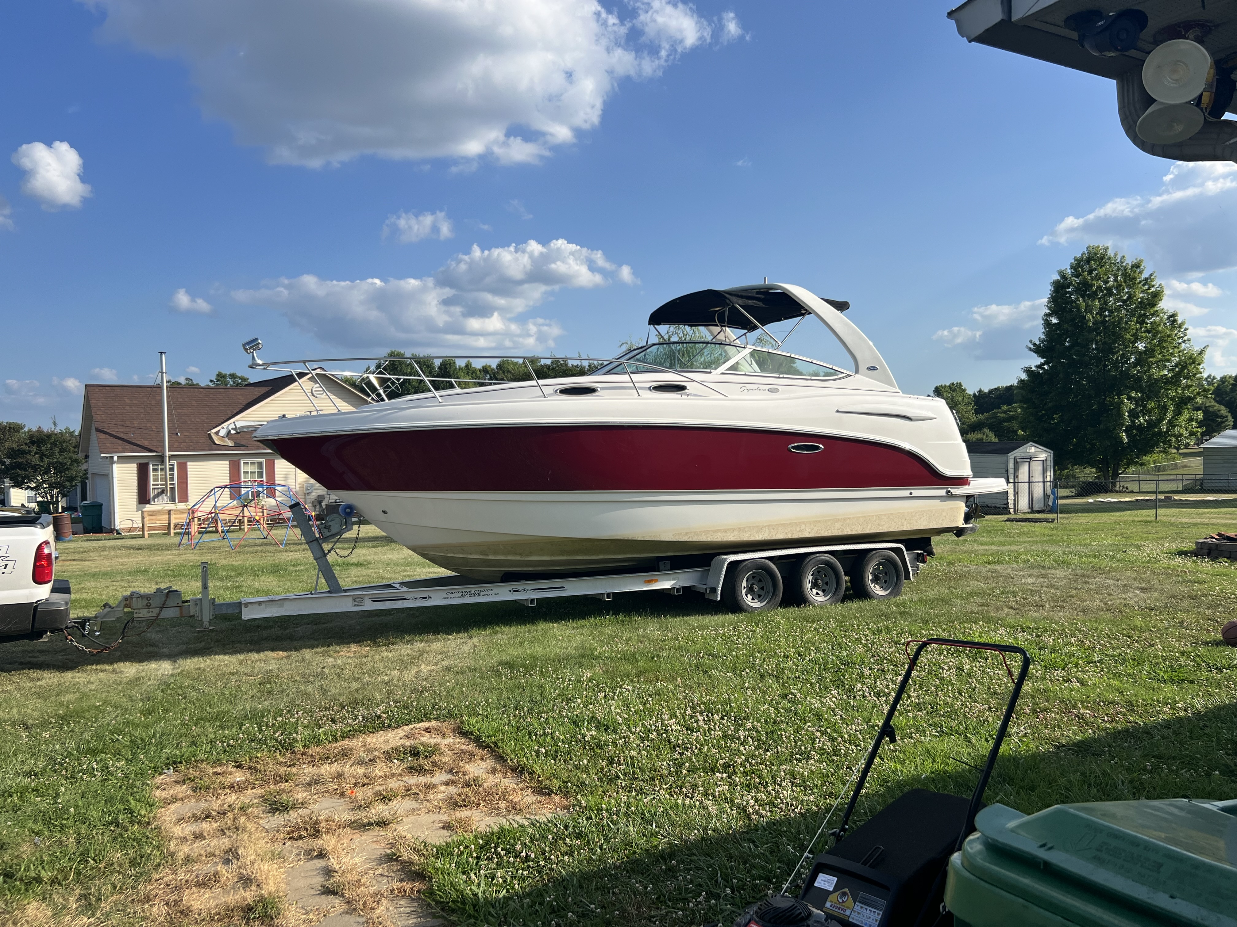

I envy you owning a Sig 270. Ever since I first saw one at the Toronto boat show 10+ years ago, I said to myself, "That boat fits me perfectly." But cost of purchase and yearly maintenance was beyond me reach.
Country70
Thanks I love my 270. The fuel gauge does not work but I did stick a rope down in the tank to check and it came out dry!
