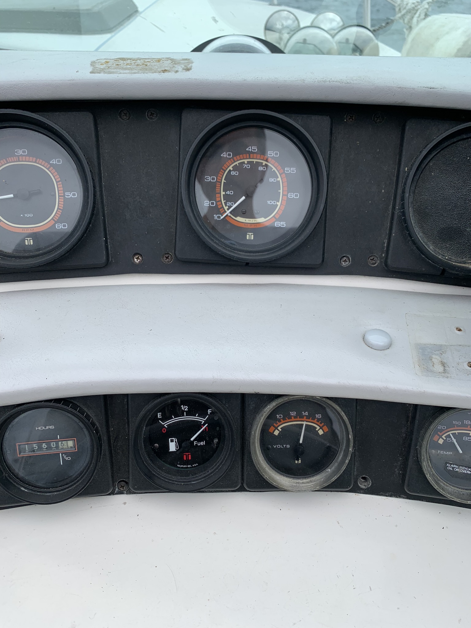

Lost my instrument panel lighting while instruments still working
I was looking forward to boating yesterday and catch a nice sunset. The wind was decreasing and therefore the waves were coming down too. Throw the anchor and enjoy. BUT....
The first problem was the trim. I've been operating my boat since 2008 with the trim gauge working and sometimes not. I can also feel if I trim to much as the prop begins to cavitate. I just hit the trim switch a little bit and readjust. No biggy....ever. For the past two years the trim gauge has been out of service. All by feel. Today, as I'm accelerating and trimming as I come on plane, without any warning of feel, the prop/ rpm jumps from 3000 rpm to 4000 rpm. I tried to trim it back but it wouldn't work. I had to retard the throttle back to neutral and retrim. Repeated this several times. Finally, after several attempts, I got the rpm to 3200 and slowly trimmed until the speedometer reached 30mph which was also in agreement with the GPS. It held. Don't have an explanation.
Next problem: Earlier in the season I thought I was having an alternator problem. But everything seemed ok. I've been putting a battery charger on the battery at the end of a run and it continuously says "100%." It must be charging to get that. So, last night, after getting it trimmed I'm outside the breakwall and watching the gauges. It was still a little bumpy and as I lightly bounced, the needles in the gauges would jiggle at the same time the instrument lights flickered. I turned around and headed back in. After a few minutes I noticed that all the instruments went dark. I immediately took the short cut back inside the breakwall and directly to my slip hoping the battery doesn't die on me before I get there. I was surprised to see that all the instruments were still working. The voltage gauge went from 13.1 to 14.1 when the lights went out. When I got back to the slip, I hooked up the battery charger expecting it to be nearly dead........again 100%.
I have noticed in the past that sometimes when shifting, the lights and the needles go nuts until the shifter is in position.

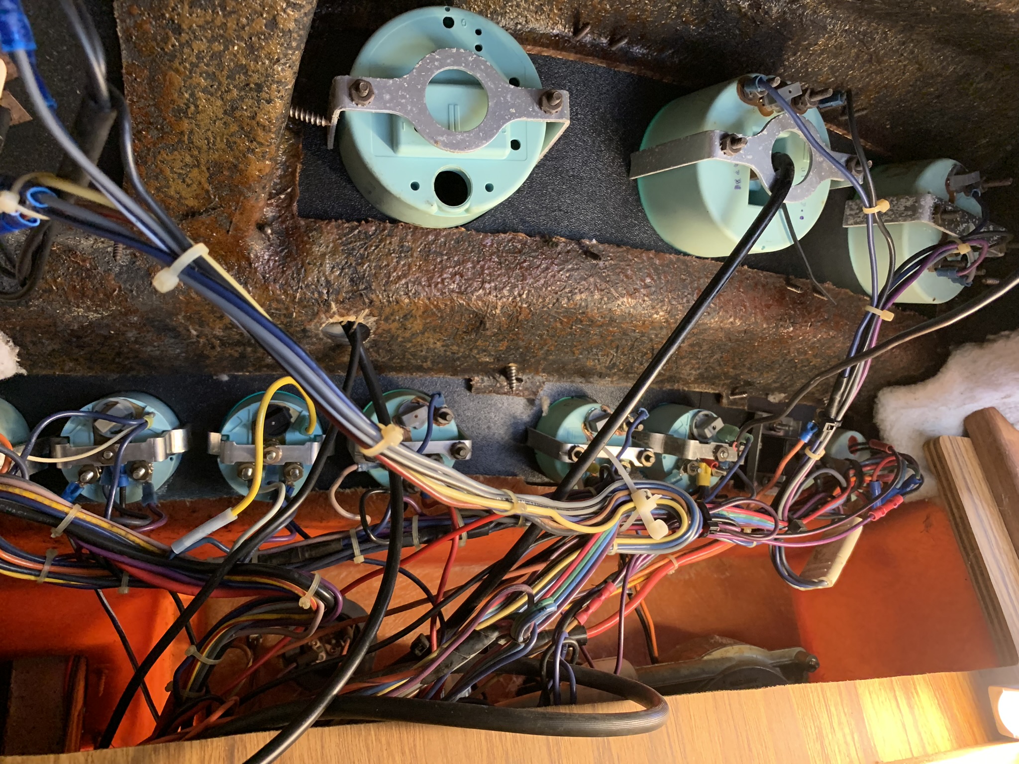

Mission accomplished.....sort of. Here is a view of my spaghetti behind the instrument panel.
Before poking around I disconnected the battery. Then I "climbed in" and start looking around. With Dennys comment about wires being pig tailed, they stuck out fairly quick. The bulb is powered by two wires. One blue and one black. They all got pig tailed in different places. I poked, lightly yanked and jiggles the wires to see if anything obvious sticks out. I found a rather large black wire that is hooked up to the clock and I thought that might be the main electrical feed. But the surrounding wiring didn't make sense. So, at this point, I hooked up the battery and turned the ignition on [no engine start yet] and sure enough, the lights came back on. I poked at the wiring some more thinking I would cause some flickering. Steady as she goes. Could not cause it to flicker or just go dark. I did find two loose wires attached to the instruments. I jiggled one wire, and it caused the light on that instrument to go out. But it did not affect the others in the bank. Same result with the second wire. It only effected that instrument.

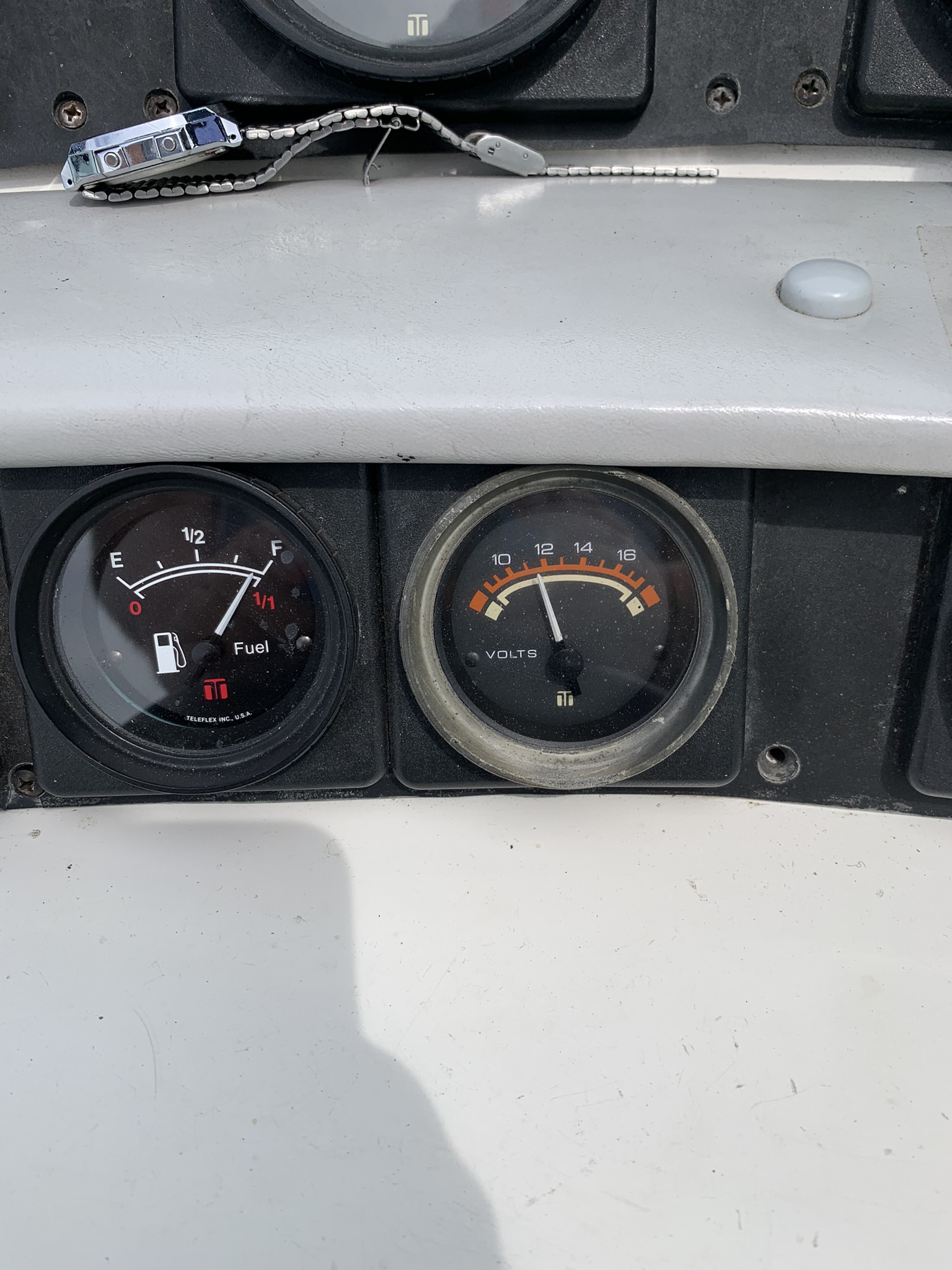

The other concern has been the alternator. While cruising around watching the instruments, the voltage meter seems to have maintained a steady 14.1v for most of this ride. It usually drops to 13.1v to 12.5v. Is this, ok?
After cruising around for nearly 40 minutes I shut off the engine and took a swim and to scrub some slime off the outdrive. No accessories were on except the blower prior to start and the clock of course. I ran the blower for maybe 5 minutes while I put everything away and started the engine. The voltmeter read 11.5v.
When I put it into gear, it went back up to its usual indications. Is this normal?

Sorry about the color choice, I knew it was either blue or purple. the black wire you seen was a ground wire. If wired to neg. ground, the wire will be black on cars and boats, at least this is what I have always found. Sounds like there is loose connection somewhere. maybe the fuse or a broken wire. Me, I would locate the that fuse and work back to the panel.
I did check the wiring at the battery which had a couple of fuses. I opened them, still good and put them back. I wasn't paying attention as to whether these caused the outage or not. The boat comes out of the water tomorrow and I'll see if I can simulate the problem from those fuses.
