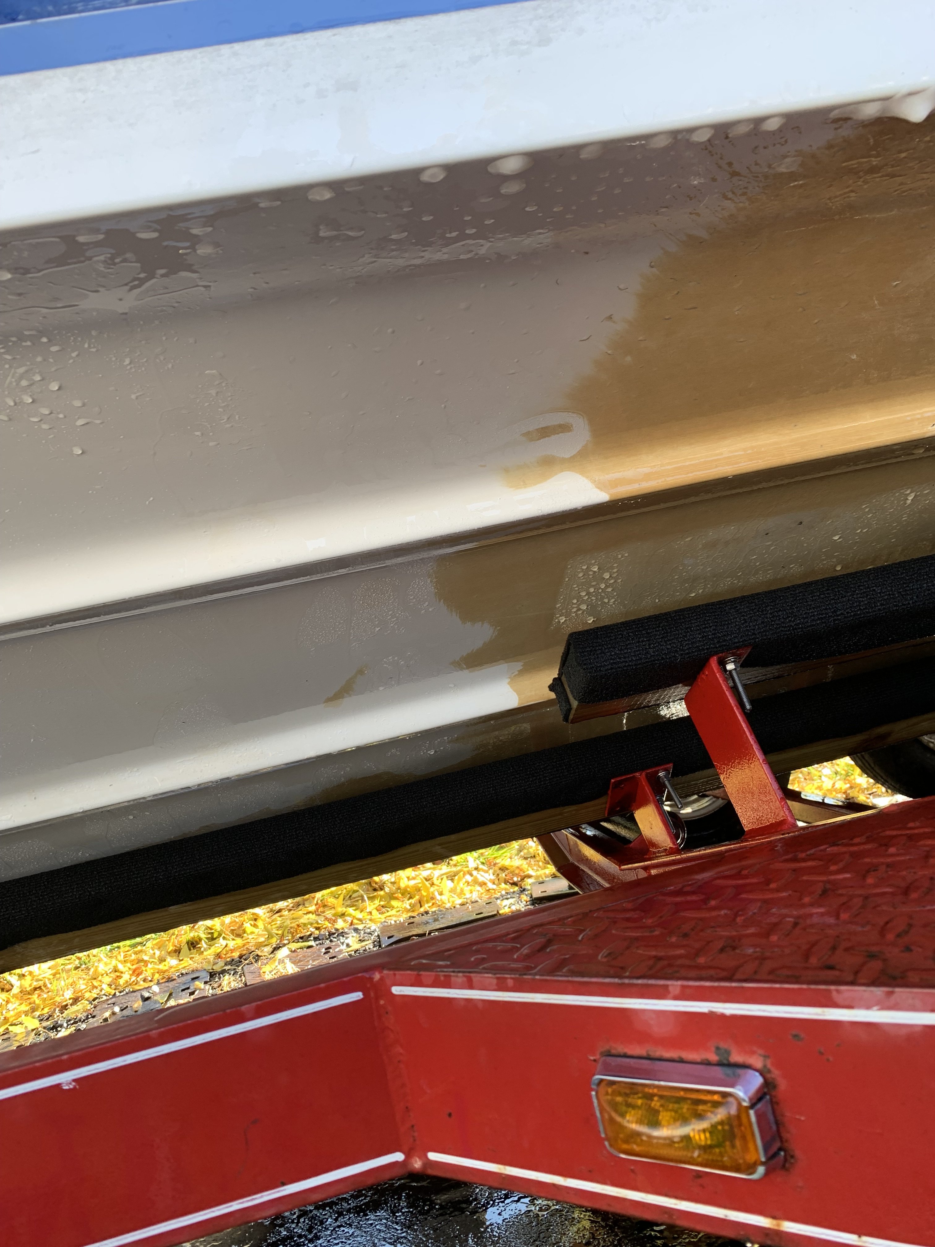

As for cleaning the bottom at the end of the season, I give it an acid bath the same way I put treatment on it. Raise and lower the boat and trailer. I take a paint pad and apply it. This minimizes drip. Then flush it like hell including the trailer.

Here is my boat with a partially complete acid bath. The 721 bottom treatment did a good job of protecting my hull. No extreme slime or zebra muscles. The bath is easy to do, it just takes time.
