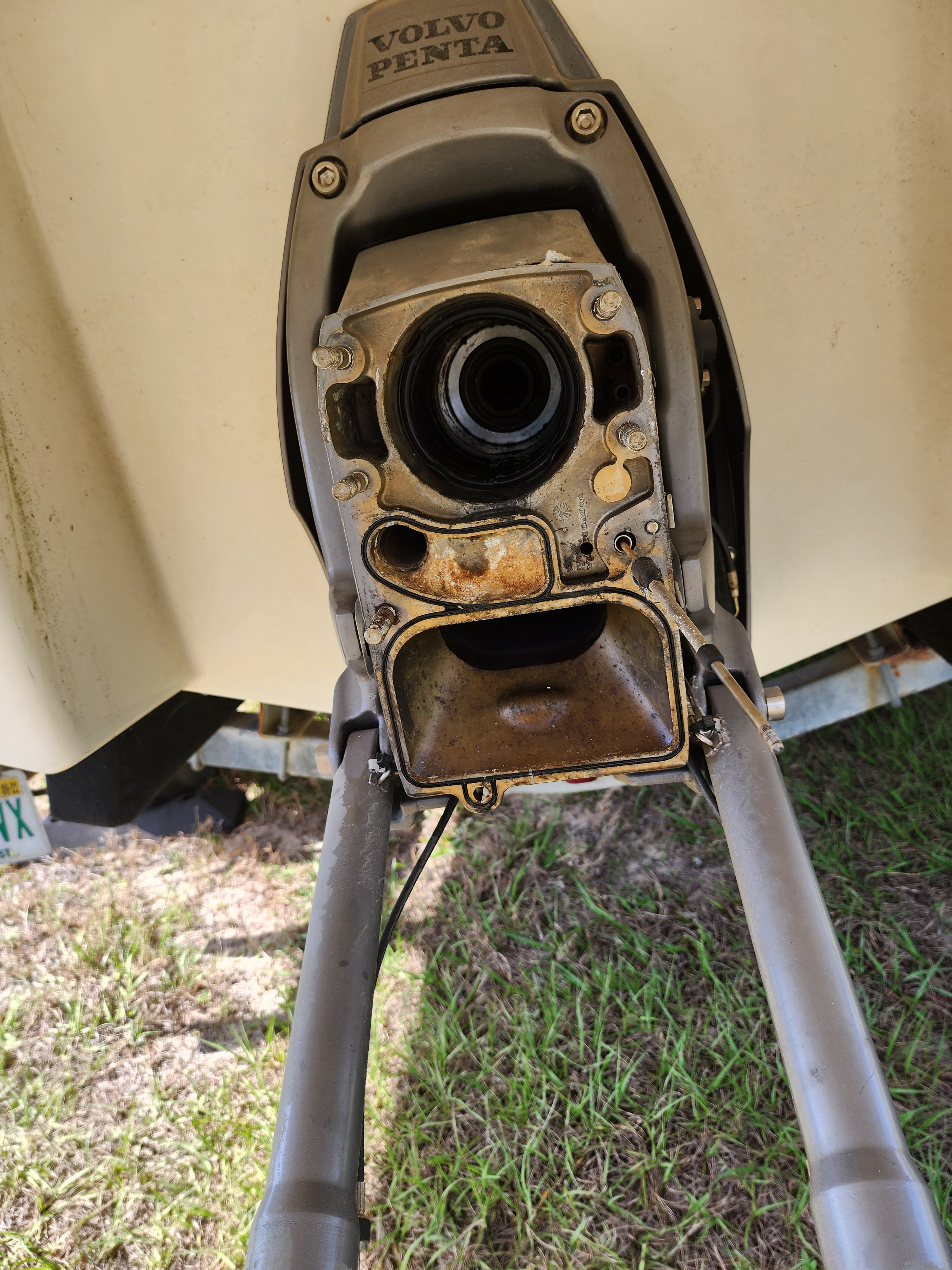

Hello! Looking for some help. I own a 2008 Chaparral 224 SSX with a Volvo-Penta 5.0 Gx-J. Transom Assembly SX_Alt-32 and a DPS_A 1.95 Drive unit.
This boat has been pretty good to me. Have gave me more than a decade of fun and good behavior. Very little repairs needed if any. Just maintenance until now. Have to lift the engine, leak from the oil pan. The SELOC repair manual is telling me that although not necessary, but highly recommended to remove the Drive unit.

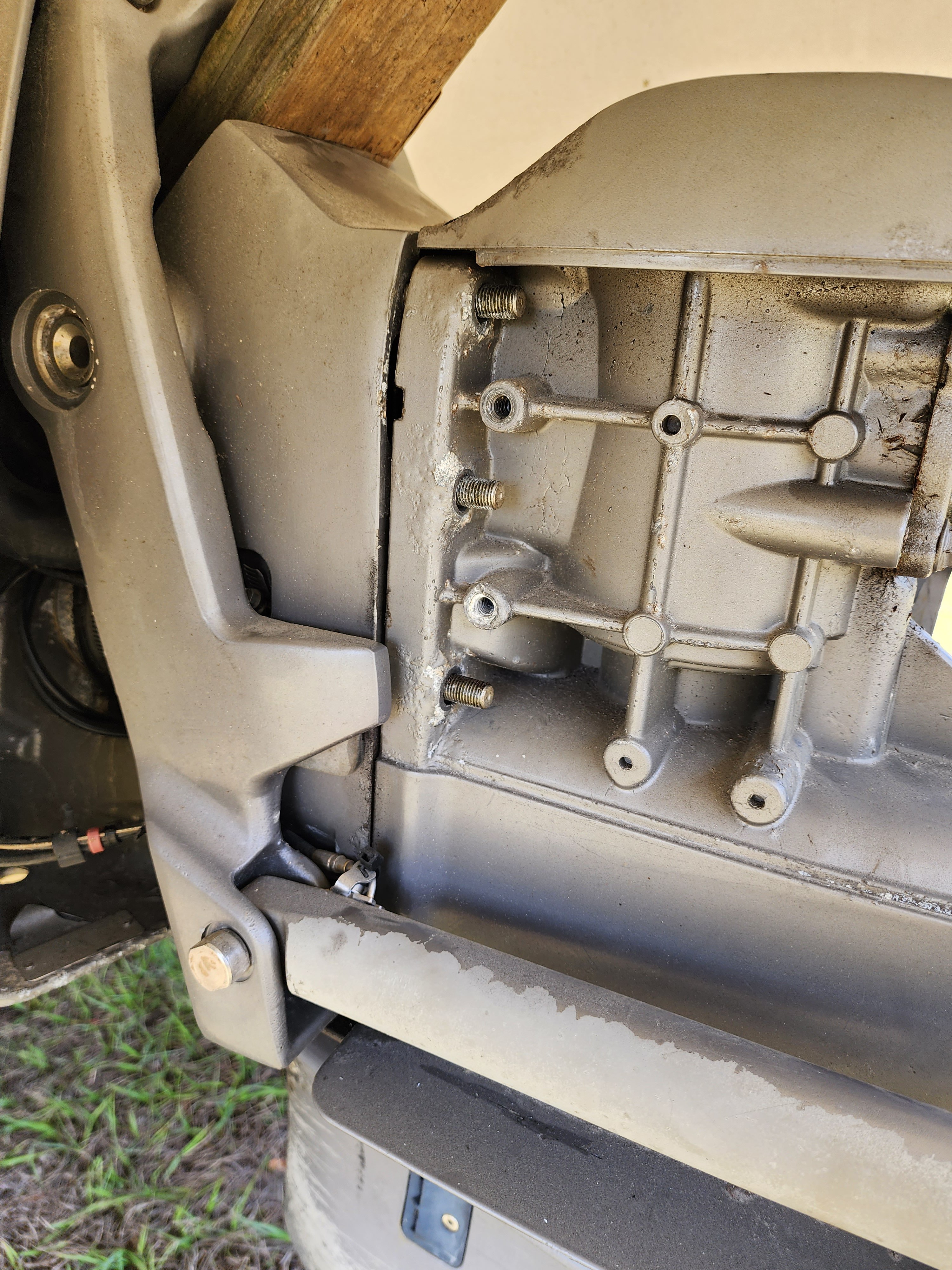

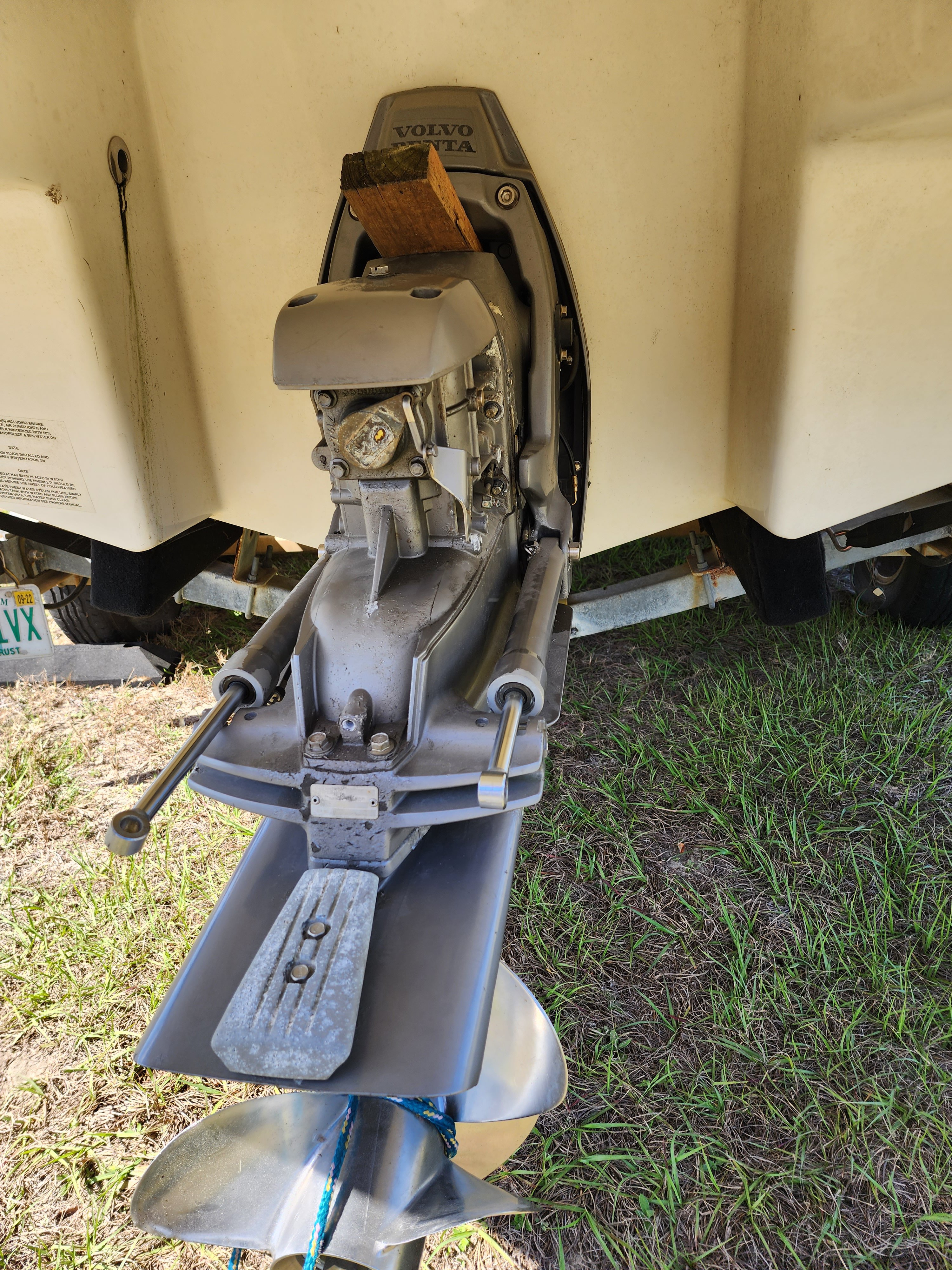

Here is the issue; I fallow all the steps indicated on the manual to remove the drive unit. Bolts, hydraulics cylinders, throttle cable etc. Read and fallow the instructions several times. But the unit does not want to come out. Used a technique from You tube, recommending to us the boat own hydraulic to push it out. Nope. I even use a small tractor to try to pull it (very carefully of course). Nothing. It pulls back by hand a bit under 1/2 inch. If I apply "extra" force about 1 and 1/4 inches.
A boat mechanic told me that, could be so much corrosion inside that is making it harder to pull it out.
I have attached some photos.
Any ideas??? Tips, recommendations, etc.
Thank You

I am no mechanic, and know absolutely nothing about the newer stuff. But I know on my older Mercruiser outdrive, you have to push the throttle all the way in forward in order to remove the drive.

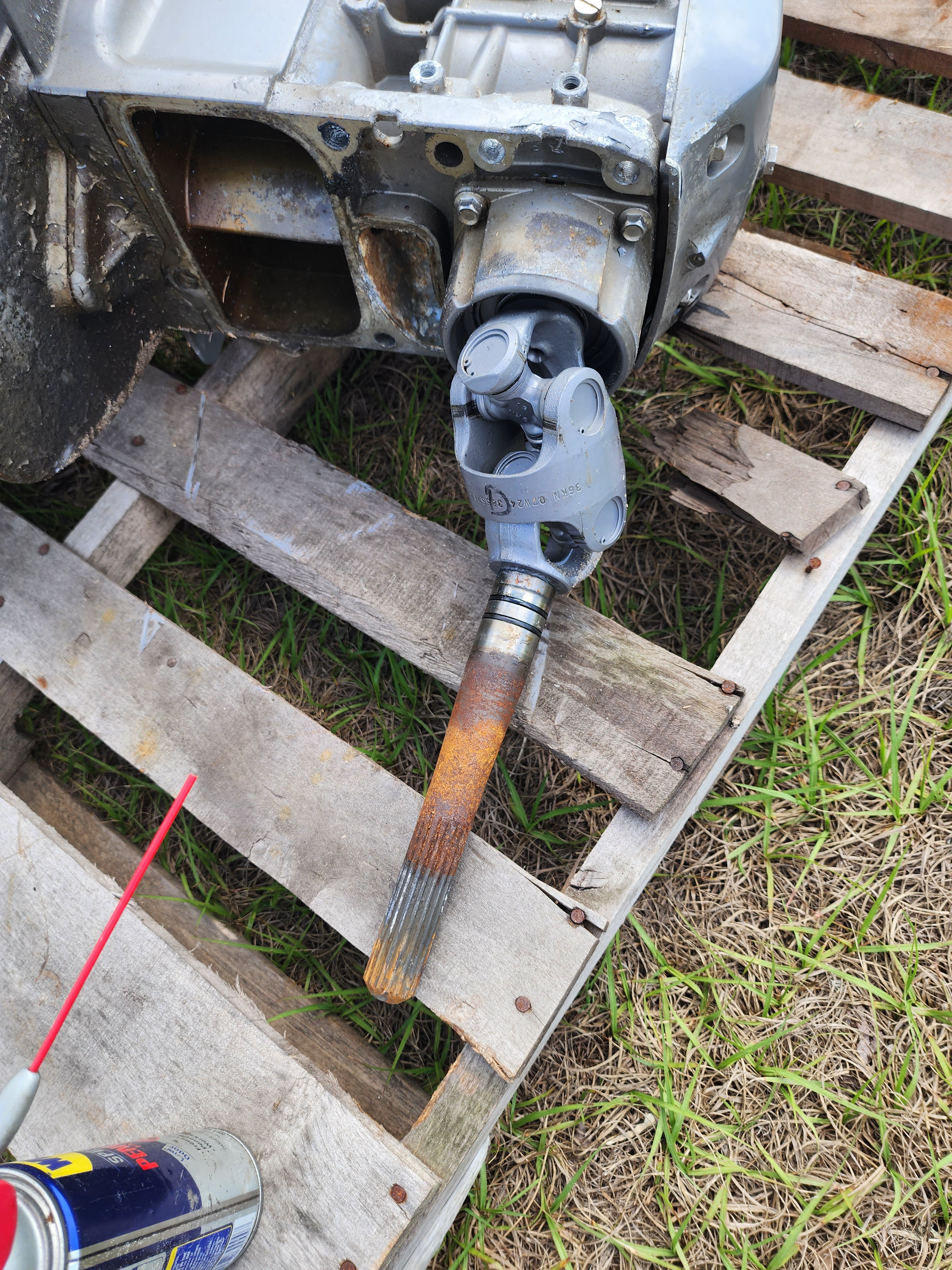

I want to thank you for the great video. If help me confirm that I was fallowing the right procedures. I end up having to pull it with a John Deere tractor 3025E (So you have an idea how "stuck" it was). "Choke" the trailer wheels, tractor on full traction. Worked on it for about 3hrs before finally, after a big pull/drop it came out.
It have some corrosion there, but everything looks intact.
Again, tank you

Did water get in there? The shaft is really rusted.

Picture of neglect.:cry:
