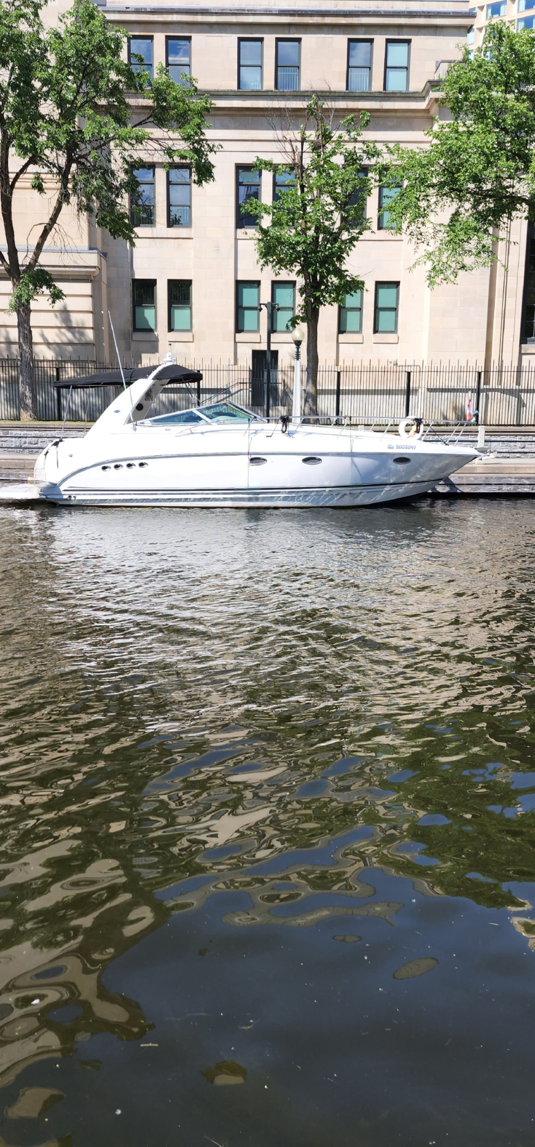

Has anyone installed Auto pilot on their 350 370 chaparral.
My boat has twin 8.1 V drives
