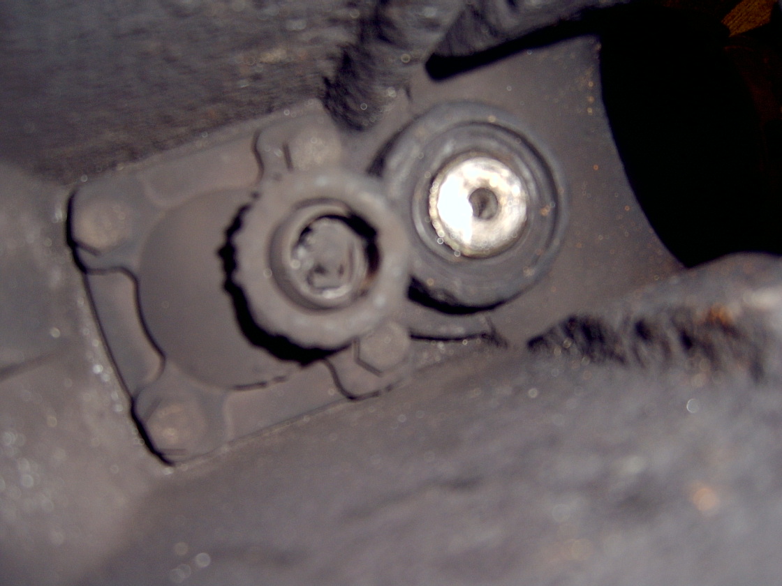

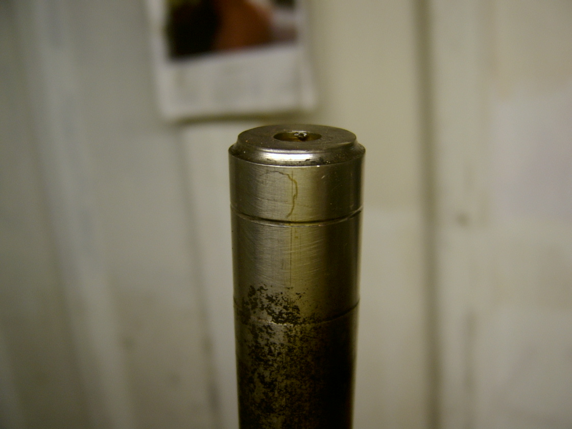

:oops: This is the result of an underwater strike , may have been hit 2 years prior.No one knows.Underwater strikes result in damage that may not be visable initially.Also where the O ring went is a known weak spot in the drive shaft.The second pic is the result of a severe overheat condition. the waterpocket cover was destroyed.
